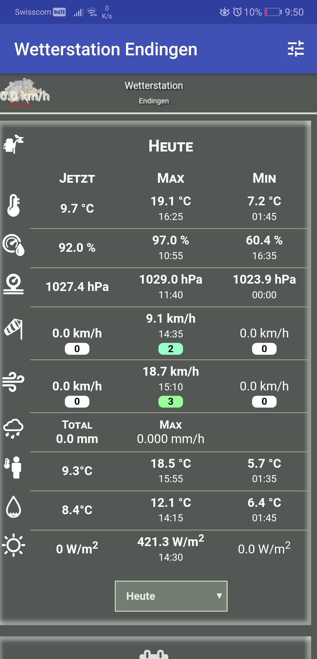

- iatros
- Language Admin
- Posts: 147
- Joined: Mon Aug 21, 2017 5:56 am
- Location: Flims Waldhaus Switzerland
- Station model: Davis Pro 2 6163
- Software: Meteobridge
- Contact:
Re: Android App Brainstorming
Hi Polbrieuc
Thanks for your reply.
The screenshot shows what I see, and since I did not define any blocks, I don't expect to see any...
Good night, Martin

- polbrieuc
- Advisor
- Posts: 98
- Joined: Wed Dec 06, 2017 10:58 pm
- Location: Vallirana
- Station model: WH1080
- Software: Cumulus
- Contact:
Hi Martin,
I am not quite sure I understand the issue here.
The app is showing the expected content, ie the mobile version of your site.
You may want to go the the app Plugin setup and remove the empty blocks that are still configured (also change visibility to the webcam option, etc)
Remember to clean the cache (in Settings/Data&Sync) in the app to see your changes reflected.
Or did I misunderstood and your issue is about the left menu not showing ?
I see nothing out of place in the bug report you sent.
Cheers,
Pol-Brieuc
Cheers,
Pol-Brieuc
