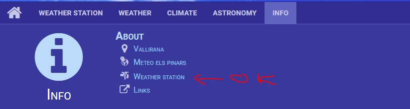

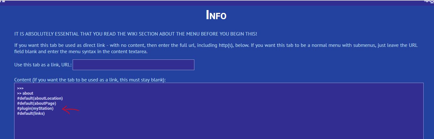

Hello all,
I am new to Meteotemplate (actually my first post) and I am not sure about the mobile menu behavior.
When modify the menu in the admin page, does it also impacts the mobile menu ?
Specifically, I added the plugin myStation and expected to see it both in the desktop and mobile version :
The desktop menu is fine (it correctly links to plugins/myStation/index.php):
But the mobile one does not show the plugin myStation, it still shows the default station page, although I took it off in the menu setup (it links to mobile/pages/other/aboutStation.php ):
Would this be cache related ?
Should I customize the mobile menu manually ?

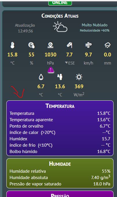

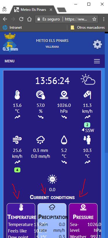

And a second question to @meteocaldas : how did you get the "more" section of the Current block to display correctly on mobile ?
Mine looks like that :
While your looks great :
Did you modify the CurrentBlock.php to modify the table or is there some kind of responsive behavior ?
[EDIT] I finally copied the currentBlock, modified its name to currentMobile, adjusted the php so the sections are in separate rows in the table and it works : https://www.elspinars.es/indexMobile.php

Re: Customize /disable mobile menu
the mobile section only includes the basic pages which are optimized for small screens, therefore also the menu is fixed and only includes links to the optimized pages. All higher end phones should be able to display the desktop version just fine (in landscape mode)

Hi, it looks like you have already solved the problem, and it also looks like that we both are lovers of "vertical" mobile
I can't get used to MT in horizontal mobile, because I am not able to read the whole block without sliding it several times.
As Jachym said, he creates blocks to work well in desktop and in H-mobile, and the great majority of blocks does exactly that.
However, sometimes, (like the more part of the current block), the design is not suitable for V-mobile devices (5"-7" V-screens), and the only solution is to customize the block as we did.
I always try to use the same block for both desktop and V-Mobile, and that is usually achieved just by modifying some text font sizes and some other minor details.
When such thing is impossible, then the best way is to create a "mobile block version" as you did, and work on it until the result is fine. Your current block looks perfect in V-mobile!
