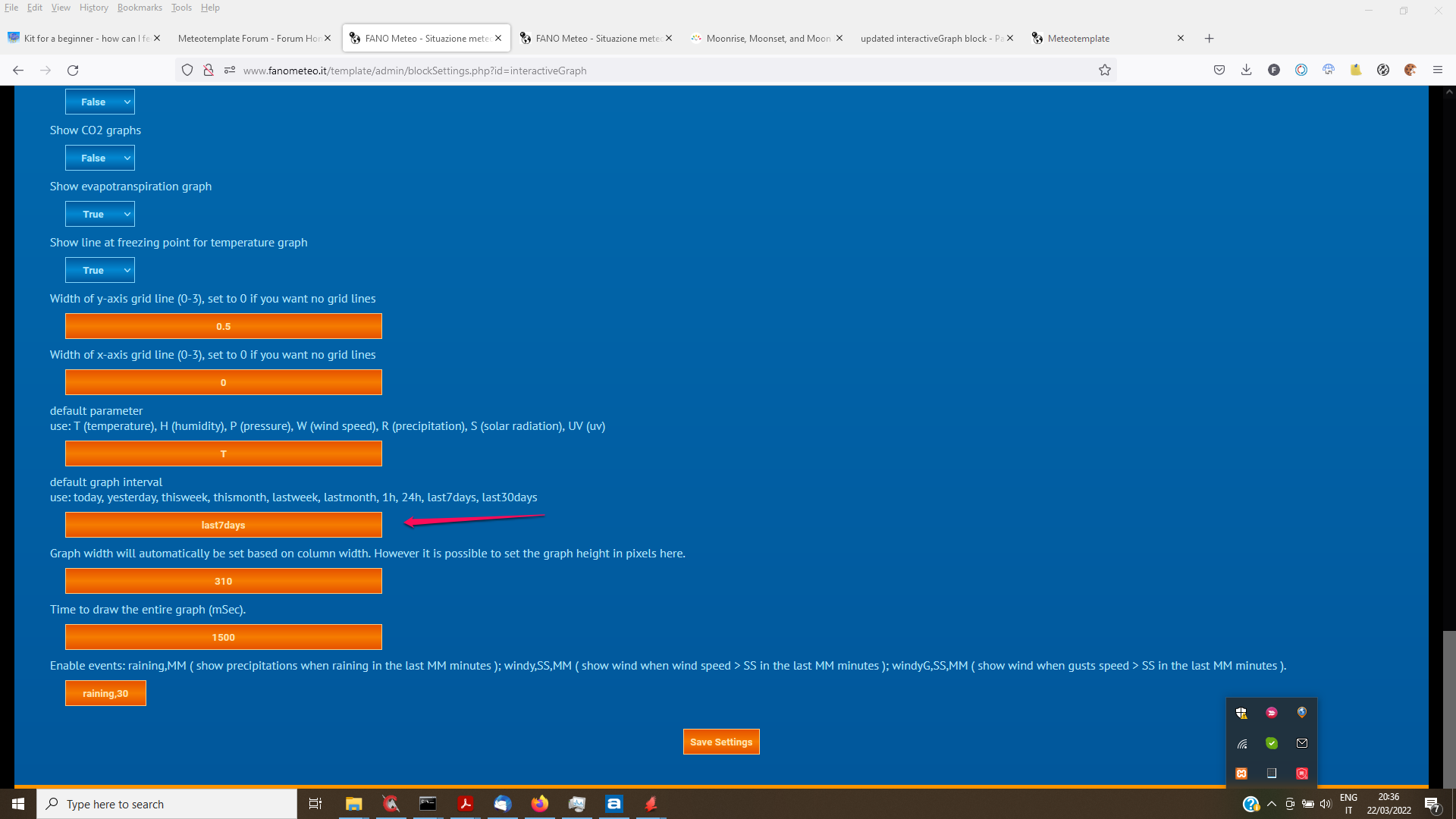

You could have a typo in the 'default graph interval' setting: last30days ( and not 30d )

You could have a typo in the 'default graph interval' setting: last30days ( and not 30d )/quote]
It was indeed, explains why I saw data in the graph until 2011,

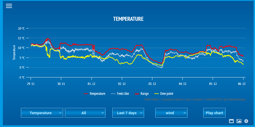

Hello David,
You said Wednesday to have a look at the http://www.fanometeo.it/template/pages/ ... hp?var=SM1 page on your site, I have seen it for a while and now I want to see it again and I only get a white screen and a security message, has something changed on the page, when I want to go to your PM10 page I also get a white screen
Gerrit
Gerrit
Re: updated interactiveGraph block
It should be ok now ( only a 'small error' in dealing with cached data )

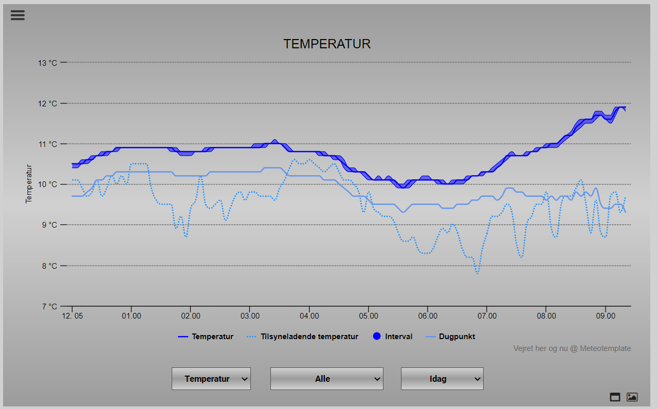

Hello

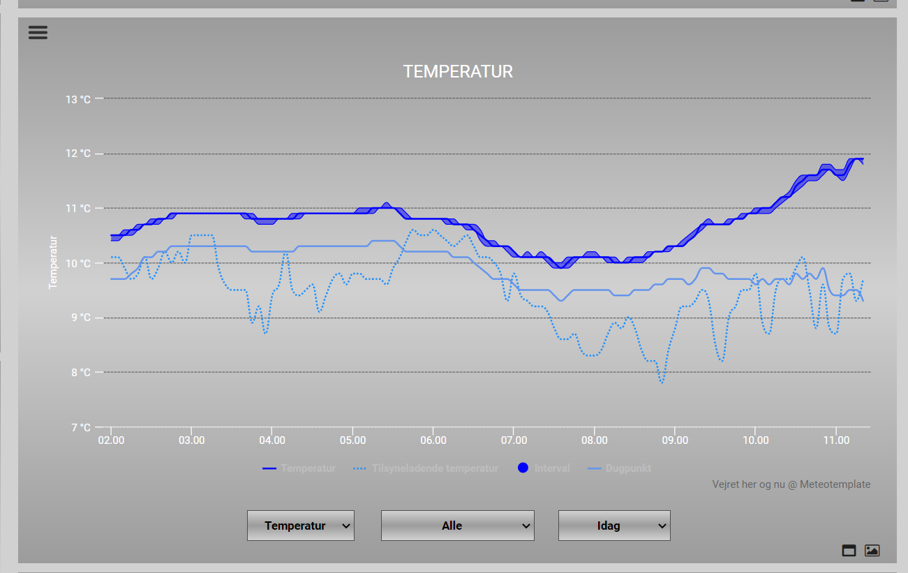

I have a problem with the interactive graph.
When opening my page the time on the graph is two hours ahead of the actual time.
(today starts at 2)
Data is correct in the database.
If i then select the 3 bars in the upper left corner of the block (menu option)
and select interactive graph it loads correct (and in the correct backgraund color) I can not figure out how to get it to load correctly in the first place (anything to do with high chart, Denmark is 2 hours ahead of UTC i the summer)
Thanks for the updated block, really good work.
georg

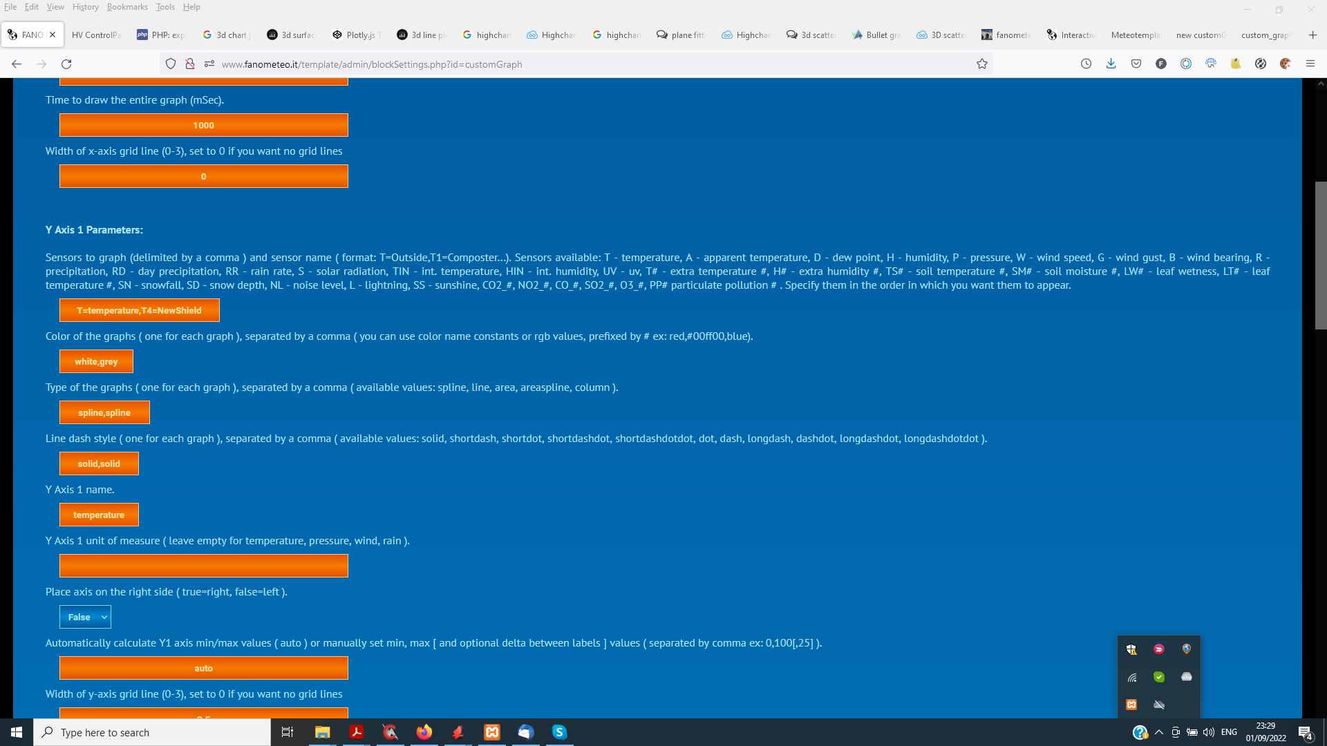

Is there already a method to have 3 Temperature sensors (T,T1,T2) show in one graph?
And how do I designate sensors (T1, T2) to the correct numbers for the colors/names?
You can use the customGraph block, it can show any sensor on a maximum of 4 different Y axis.
For temp only sensors you need to set the initial parameters ( Y axis 1 parameters )
This is the configuration I use for the first axis ( simply add the third temp sensor in the highlighted fields )
You can also do a 'little of math' if you need ( for example I defined the fourth axis as: T-T4=delta

Sorry, I don't understand your explanation here.davidefa wrote: ↑Thu Sep 01, 2022 9:46 pm You can use the customGraph block, it can show any sensor on a maximum of 4 different Y axis.
If I have 3 sensors, T,T1,T2 that I want to show in one graph, how do I enter its values?

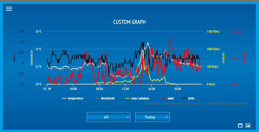

See the customGraph in the center here; It's really strange, the time on the horizontal axis is incorrect (it shows the future?).
Also, the naming of the colors under it is in km/h (probably mingles with code from windrose?)..
I have exactly the same issues, but with customGraph. Looks like a style naming convention issue interacting with another block (windRose?).

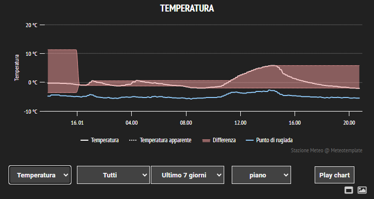

is there any possibility to remove the max-min highlited red area ?
I'm currently using rev 12.0
Marco
