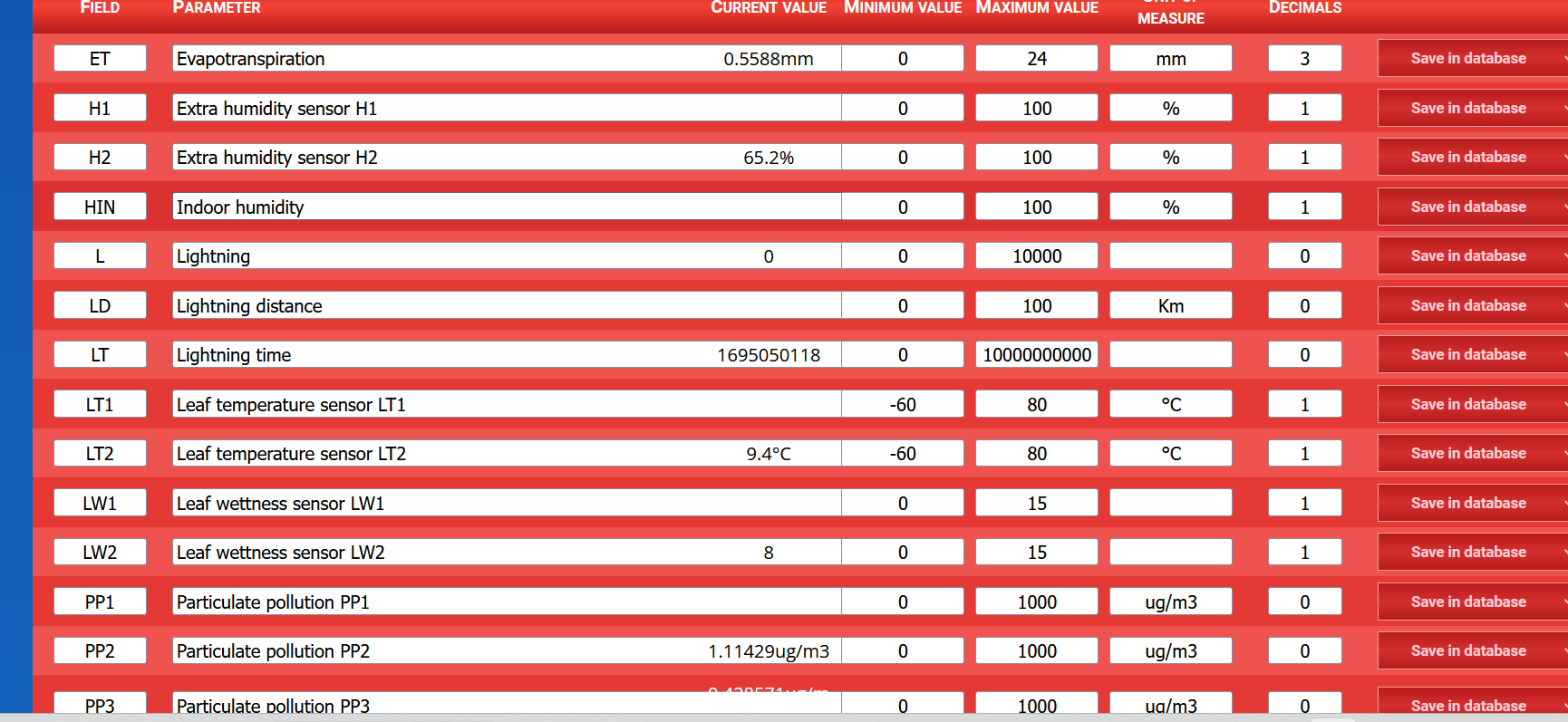

I always taught of a way to configure/add extrasensors in a centralized way.
So that every block/plugin/page could know the available sensors, names, unit used, limits and so on.
You can use this, for example, to extend the limits of 8 extra temperature sensors ( if you need ), or to add a second rain/wind sensor or...
NOTE
This is a preliminary version I'm currently testing.
At the moment, no block/plugin make use of this extension.. but things should change.
The only usage, for the moment, is to add new field/sensors to the alldataExtra database.
INSTALL
If you feel brave and want install it ( helping me troubleshooting ) make a backup copy of original scripts.
To install simply uncompress the archive in the root meteotemplate directory.
USAGE
You can run the setup via meteotemplate control panel -> Database -> Extra Sensors.
The first time you run the setup simply click the save button and an extended configuration ( corresponding to the actual one ) will be saved.
Extra Sensors Extended
- ExtraSensorsEx01.png (181.33 KiB) Viewed 16480 times
- ExtraSensorsEx.zip
- (17.78 KiB) Downloaded 582 times

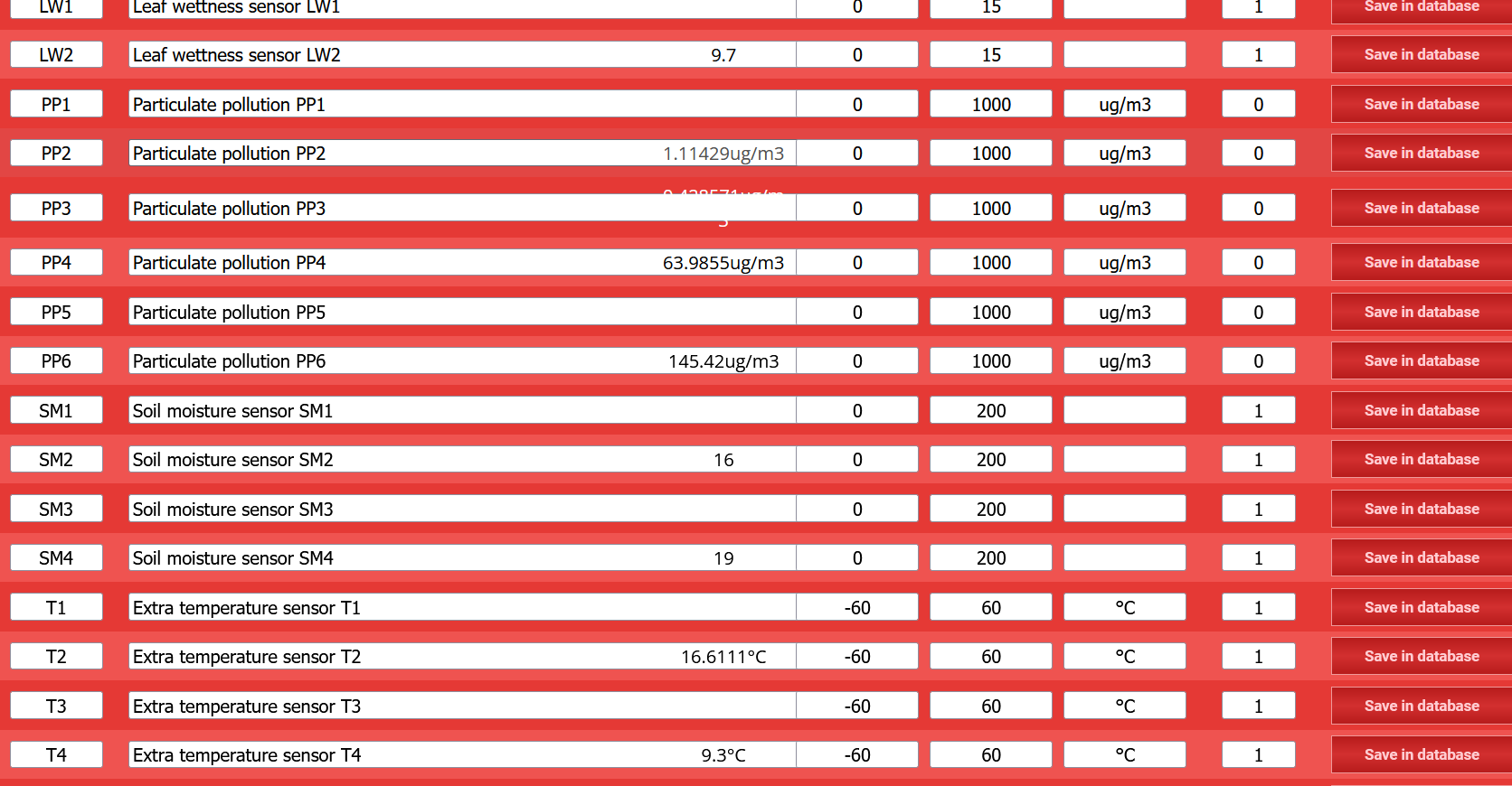

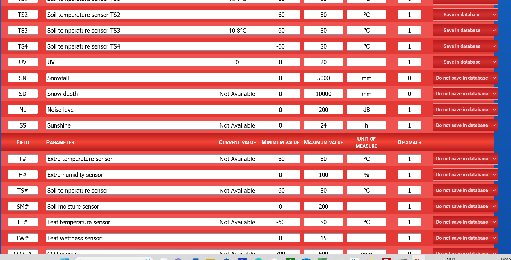

Hi David,
see my screenshots attached.
not all of my 'saved in database' sensors are shown.
with pp3 ther's a small lay out issue.
Thank you very much!!
Alex
Alex
- 3.png (174.83 KiB) Viewed 16450 times
- 2.png (153.71 KiB) Viewed 16450 times
- 1.png (165.06 KiB) Viewed 16450 times

Re: Extra Sensors Extended
and also it has influence on the rest of the MT site: extra sensors are not saved in the database, graphcombined is not updated with new values, station data is only updated with the non extra sensors like outdoor temp, hum, wind rain etc....
I will revert back to the old api ..
but its a nice exercise...
Grtz
a
Grtz
a
