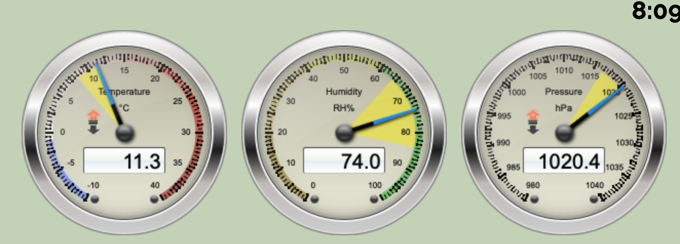

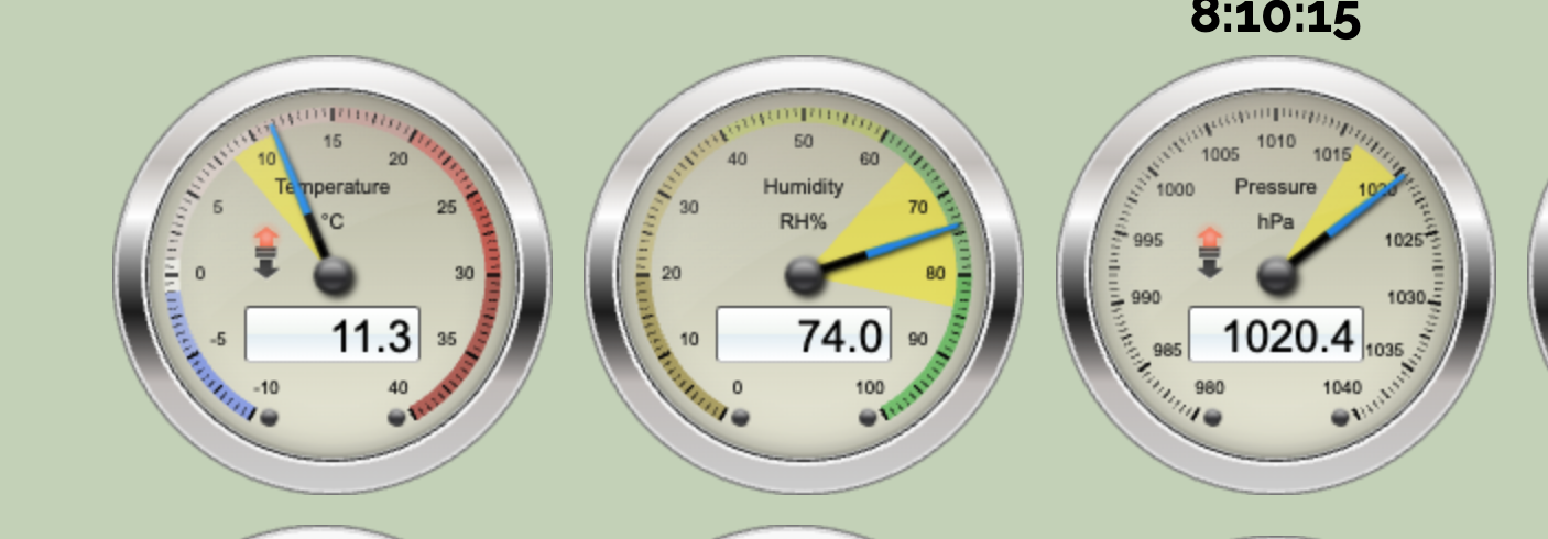

I have noticed that the resolution of steelseries gauges is rather poor...it seems better on google chrome browser than for instance safari...see attached example screen shot (both on 4k monitor)
Safari
Safari
Chrome
Chrome
Is there a way to improve this ?
Leon Rossouw.
Re: steelSeries plugin error: MIME type mismatch (X-Content-Type-Options: nosniff)
Post by davidefa » Tue Aug 09, 2022 9:01 pm
I'd say it could be a 'browser effect' ( but I'm not sure and I can't reproduce having no safari at hand ).
Verify if the 'image looks good' at 100% zoom and get worse zooming in, it could be the effect of some antialiasing/optimization/speedup setting of the browser.
